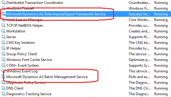

First, AX is no more a WinForms application, it is a website. There is no "AOS” as such, my friends. Though still a couple of Windows services run on the server side:
· Batch management services that “Polls and executes AX batch requests.”
· DIXF service that “Executes import/export logic for the Microsoft Dynamics AX Data Import/Export Framework”.

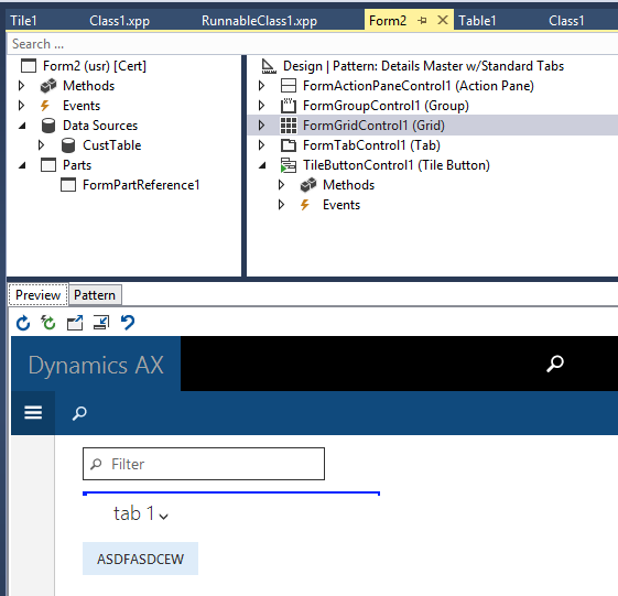

IDE now provides a nice relevant form preview feature.

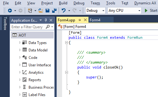

Unlike in older versions every form is now a separate class that extends FormRun and is decorated with [Form] attribute. That opens new perspectives for OOP usage in your UI development.
For example, your form can now implement interfaces, that may be convenient in caller patterns or in extensions if you want all your forms to behave similarly.

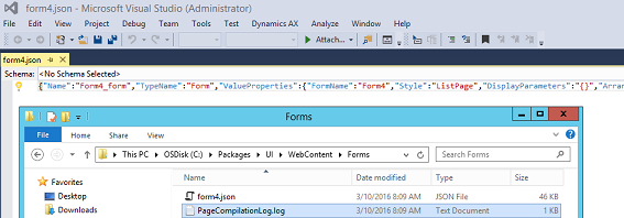

You can also see a draft form metadata when the option “Build pre-compiled forms” is set in Build models dialog. Visual Studio pre-generates JSON form file to increase runtime performance.
Click here to open the full JSON file text.

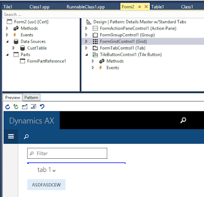

This is an important innovation to forms development – strict patterns that you must follow in order to compile your form. IDE gives a nice tree-arranged details on the expected form structure that must adhere to the chosen pattern. Some patterns resemble those in AX 2012 but there many more.
Additionally, some controls like Groups may have their own subpatterns that depend on the parent form's pattern.

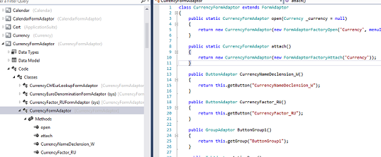

In Project properties you can choose to automatically generate form adaptor class that extends standard FormAdaptor and resides in a separate package referencing the form’s package.
It’s probably intended to contain all form-related business logic, though I have not seen the description of this BP.
Well, you can always find an example in standard code like in the example with Currencies below:
