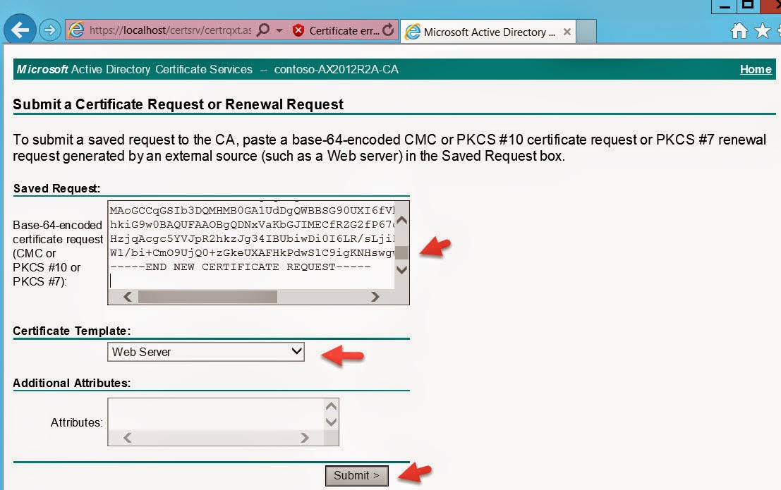

Save the file. File will look like this and the content of this file will be used for submitting the certificate request.
Now open Contoso Certificate Server, https://localhost/CertSrv to complete the certification request.
Certificate Server
Request a Certificate
Advance Certificate Request Copy paste the Certificate Request text file content, select Web Server.
Submit RequestDownload the certificate file.

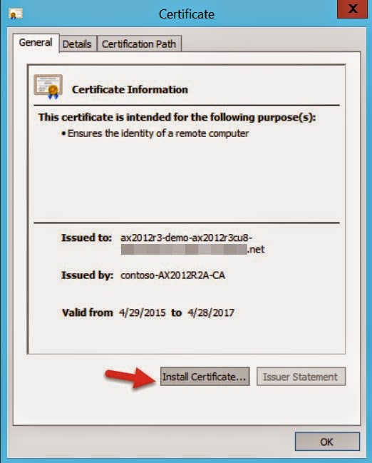

Verify certificate
Copy the thumbnail value of the certificate, will be used later while configuring the AX Mobile Connector.
Install Self-Signed SSL Certificate
We can now install this certificate for both Local Machine and Current User into both Personal and Trusted Root Certification Authorities certificate stores (4 certificate imports).
Note: We will be running our Mobile Apps for user contoso\administrator but you can use any user and just install the certificate for that user as well. In production, we will be using the certificate from Public CA.
Open the certificate and install.
Install Certificate

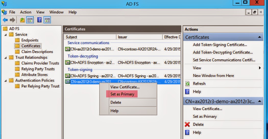

Next we’ll assign our newly created Self-Signed certificate as Service communications certificate, Token-decrypting certificate and Token-signing certificate in ADFS --> Service --> Certificates settings.
Select certificates.
Set Server Communication Certificate Set Server Communication Certificate
Confirm Yes on the next screen.
Add Token-Signing Certificate
Right click on the certificate and set as primary.
Select Yes.
Add Token-Decryption Certificate
Set as Primary.
Restart AD FS.
