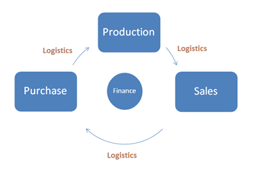

The company business cycle can be described in the following way:
Business cycle
What is the first step in this cycle? As you may know, the first step in business is finding a Customer and signing a contract. A lot of companies are launched after the Customer is found and the contract is signed. So, the first step in the business cycle is Sales, all other steps serve the Sales step.

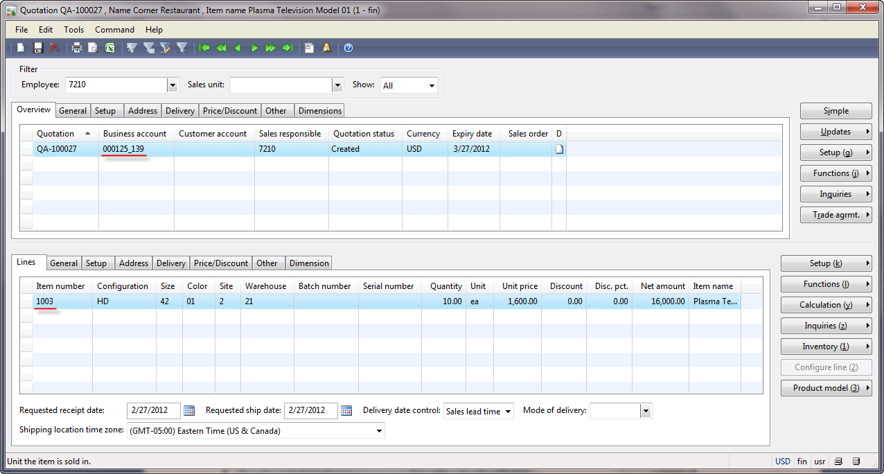

To create a sales quotation, do the following:
  1. Go to Accounts receivable > Common Forms > Sales Quotation Details. The Quotation form opens.
  2. Create a new line. The Create quotation form opens. Select, for example, the “000125_139″ value in the Business account field. Click OK.
  3. The quotation header is created.
  4. Create a new line with the following values:
    • Item number = 1003
    • Configuration = HD
    • Size = 42
    • Color = 01
    • Quantity = 10
  5. Save the line.
The Quotation form looks as follows:
Note that the Site, Warehouse, Unit, and Unit price fields are automatically filled in. The values for the Site, Warehouse, and Unit fields are filled in by analogy with the purchase line. In the purchase lesson you can find how the values are filled out.
The Unit price field contains the value of 1600. How does Microsoft Dynamics AX know the price? If we go to the Items form under Inventory management > Common Forms > Item details > find the 1003 item > Price/Discount tab > Base sales price field group, we see that the sales price is zero. If we go to the Item dimension combination form (the Items form > find 1003 item > Setup menu button > Item dimensions combination button > find the line with Configuration = HD, Size = 42, and Color = 01 > Price button), we see that only the cost price is set up. The sales price is taken from the trade agreement (the Items form > find the 1003 item > Trade agrmt. menu button > Sales price button). The Price (sales) form opens. We can see that the price for our configuration is $1600.

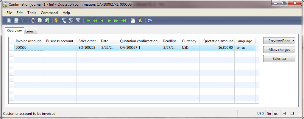

Let’s check the confirmation quotation posting results. In the Sales order form, click the Inquiries > Quotation confirmation button. Click the Inquiries > Quotation confirmation button again. The Confirmation journal form opens.
We can see that the new journal has been created with one line. This step has no influence on accounts, because from the financial point of view nothing has changed. No general ledger or sub-ledger transactions have been created. The Confirmation journal form doesn’t have the Voucher button. As you remember a voucher is used to group all transactions generated for one operation. Since the Confirmation journal form doesn’t have the Voucher button, the quotation confirmation operation never generates transactions.
Note that the quotation amount is $16 800. It is because sales taxes have been added. We will understand how sales taxes are set up and calculated later in this training.

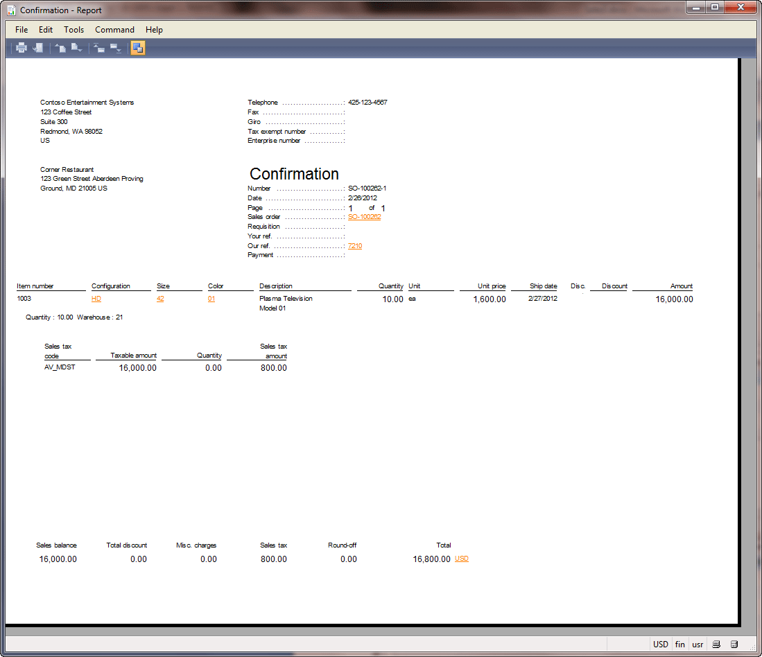

Confirmation
The confirmation step is similar to the quotation confirmation step. It is optional and can be omitted. The confirmation step is used to record in the system that the customer receives the sales order document and confirms its details (quantity, configuration, price, delivery terms, payment terms, etc.).
The Sales Manager clicks the Posting > Confirmation button in the Sales order form. The Posting confirmation form opens. Select the Print confirmation check box. To print the confirmation to the screen, click the Printer setup > Confirmation button and select the Screen option, click OK. In the Posting confirmation form, click OK. The Confirmation document is printed. The Sales Manager sends this document to the customer. If the customer asks to change some details, this step can be repeated.
To view the posting results, click the Inquiries > Confirmation button in the Sales order form. The Confirmation journal form opens.
We can see that the journal has been created. The confirmation step has no influence on accounts, because from the financial point of view nothing has changed. The Confirmation journal form doesn’t have the Voucher button. The confirmation operation never generates transactions.

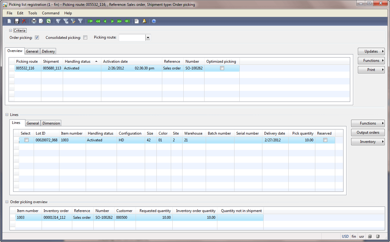

  1. In the Sales order form, click the Posting > Picking list button. The Posting picking list form opens. To print the picking list to the screen, select the Print picking list check box, click the Printer setup > Picking list button, select the Screen option, and click OK. In the Posting picking list form, click OK. The picking list is printed. The Sales Manager sends the picking list to the Warehouse Worker.
  2. When the Warehouse Worker picks all items, he or she notifies the Sales Manager. The Sales Manager registers the picking list. In the Sales order form, click the Posting > Picking list registration button. The Picking list registration form opens.
  3. Click the Update > Update all button. The value of the Handling status field is changed from Activated to Completed.

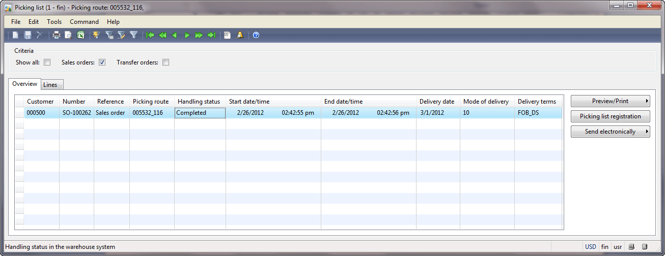

Let’s check the picking list posting results. In the Sales order form, click the Inquiries > Picking list button. The Picking list form opens.
We can see that a new journal has been created. This step has no influence on the company accounts, because from the financial point of view, nothing has changed. The Picking list form doesn’t have the Voucher button. The Picking list operation never generates transactions. Note that neither the journal header nor the lines have information about the prices (the item price or the total order price). It is because this step is not related to the financial one. The company hides some info (the prices and the customer information) from the Warehouse Workers.

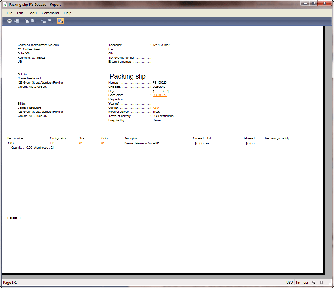

Let’s post the packing slip and check the results. In the Sales order form, click the Posting > Packing slip button. The Posting packing slip form opens. Note that you can print the packing slip document to the Screen by selecting the Print packing slip check box, clicking the Printer setup > Packing slip button, selecting Screen, and clicking OK. Click OK.
The packing slip document is printed to the screen. Note that this document doesn’t have the item price. It contains information about the item configuration and quantity.

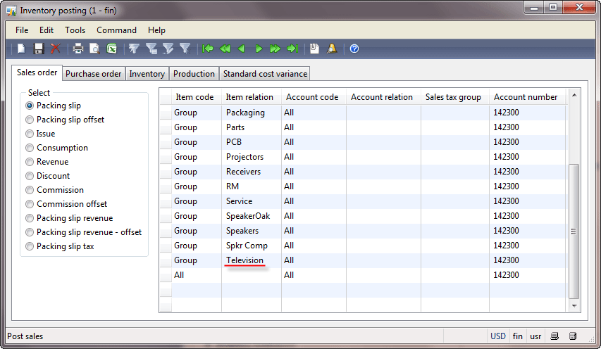

Open the items posting profiles form. Go to Inventory management > Setup > Posting > Posting. The Inventory posting form opens. The Sales order tab is shown by default. The Packing slip radio button is also selected by default. Find the settings for the “Television” item group.
This configuration is used for the Inventory un-invoiced accounts. We can see that for the 1003 item, the 142300 general ledger account is used as Inventory, un-invoiced.

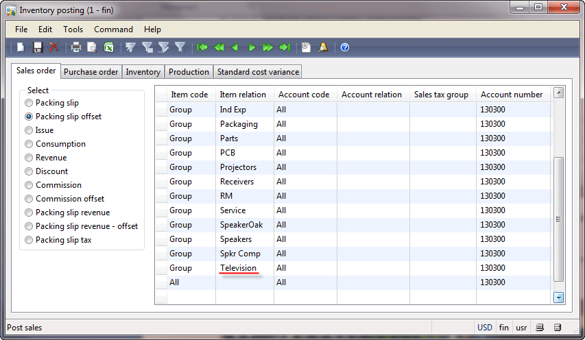

Select the Packing slip offset radio button. Find the settings for the “Television” item group. The Inventory posting profile form looks as follows:
This setup is used for Account receivable, un-invoiced accounts. We can see that for the 1003 item, the 130300 general ledger account is used as Account receivable, un-invoiced.
