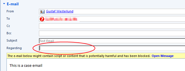

I was recently working with a customer when I noticed an interesting bug in CRM 2011, in the Outlook Client. When trying to convert an email to either a lead, case or opportunity directly from the Outlook ribbon, it does not set the "regarding" lookup field of the email that was tracked. However, if the email is first tracked, then "viewed in CRM" and then from the CRM email form converted to lead, case or opportunity, the regarding field is set correctly.

I went back to the email from Outlook and opened it in CRM and found that it had not been correctly connected to the case using the lookup "Regarding" field.

And by opening the CRM email form from the list shows it clearly:
The regarding field has been set properly.
This is a very unfortunate bug in CRM and I do hope Microsoft solve it quickly as the feature that CRM 2011 adds in Outlook by being able to convert emails to cases, opportunities and leads directly from the email form is very good but as all of you know who work close to sales or customer service people, their time is very precious and every click counts and new features that do not deliver as expected are always annoying to the user. So, until the bug has been fixed, make sure the users open the CRM form to convert the emails.
