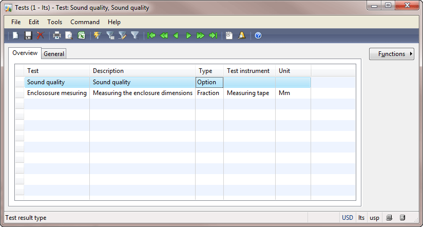

Set Up Tests
Tests are used to determine whether quality processes meet predefined specifications and standards.
A test can be quantitative (with specifications and test results expressed as values for a specified unit of measure) or qualitative (with specifications and test results expressed as user-defined outcomes that reflect pass or fail).
Microsoft Dynamics AX 2009 has the following test result types:
  • Fraction
  • Integer
  • Option
The first two relate to quantitative tests and the last one relates to qualitative tests.
The tests are set up in the Tests form (Inventory management > Setup > Quality control > Tests).
The following image displays qualitative test available in my demo data.
Tests form
Let’s change the Enclosure measuring test type from Option (qualitative test) to Fraction (quantitative test). Click Functions > Change quality test type. In the form that opens, select the Fraction value in the New type field and then click OK.
Create a new Sound quality test with the following values:
  • Test = Sound quality
  • Description = Sound quality
  • Type = Option
Tests form

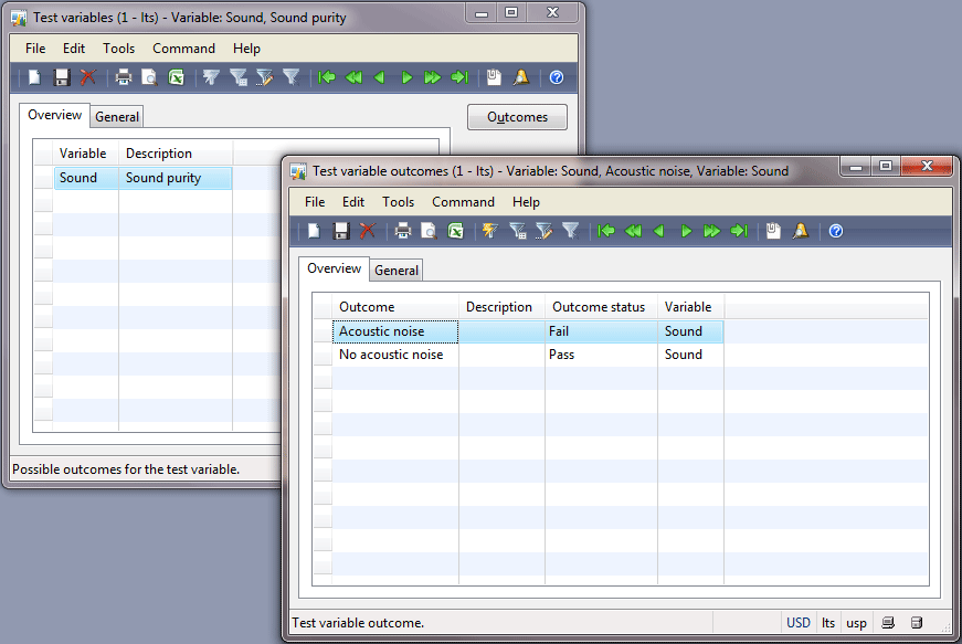

Set Up Test Variables
In Microsoft Dynamics AX 2009, the qualitative tests use test variables as a test result. Each test variable contains acceptable and unacceptable test results.
Let’s create a new Sound test variable with two possible outcomes – No acoustic noise and Acoustic noise. If there is acoustic noise in a speaker, the test result is failed.
  1. Open the Test variables form (Inventory management > Setup > Quality control >Test variables).
  2. Create a new Sound variable.
  3. Click the Outcomes button. The Test variable outcomes form opens.
  4. Create a new outcome with the following data:
    • Outcome = No acoustic noise
    • Outcome status = Pass
  5. Create one more outcome:
    • Outcome = Acoustic noise
    • Outcome status = Failed
Test variables form

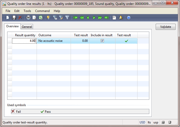

The Quality Manager finds the stored items and starts testing themes. The Quality Manager can write testing results on the paper and then enter these in the system. Unfortunately, in Microsoft Dynamics AX 2009, it is impossible to print a quality order with test instructions for the Quality Manager.
We assume that the Quality Manager receives the following testing results:
  1. Enclosure measuring test results:
    • 3 speakers have the 70mm length
    • 1 speaker has the 72 mm length
  2. Sound quality:
    • 4 speakers do not have acoustic noise
The Quality Manager returns to the working place and enters these results in the system:
  1. Open the Quality orders form (Inventory management > Periodic > Quality management > Quality orders) and find the necessary order.
  2. Select the Enclosure measuring test and click Results in the lower pane. The Quality order line results form opens.
  3. Enter the test result:
    • Result quantity = 3, Test result = 70
    • Result quantity = 1, Test result = 72
    Close the form.
  4. Select the Sound quality test and click Results. In the Quality order line results form, enter the test result:
    • Result quantity = 4, Outcome = No acoustic noise
    Close the form.

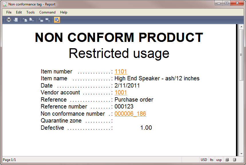

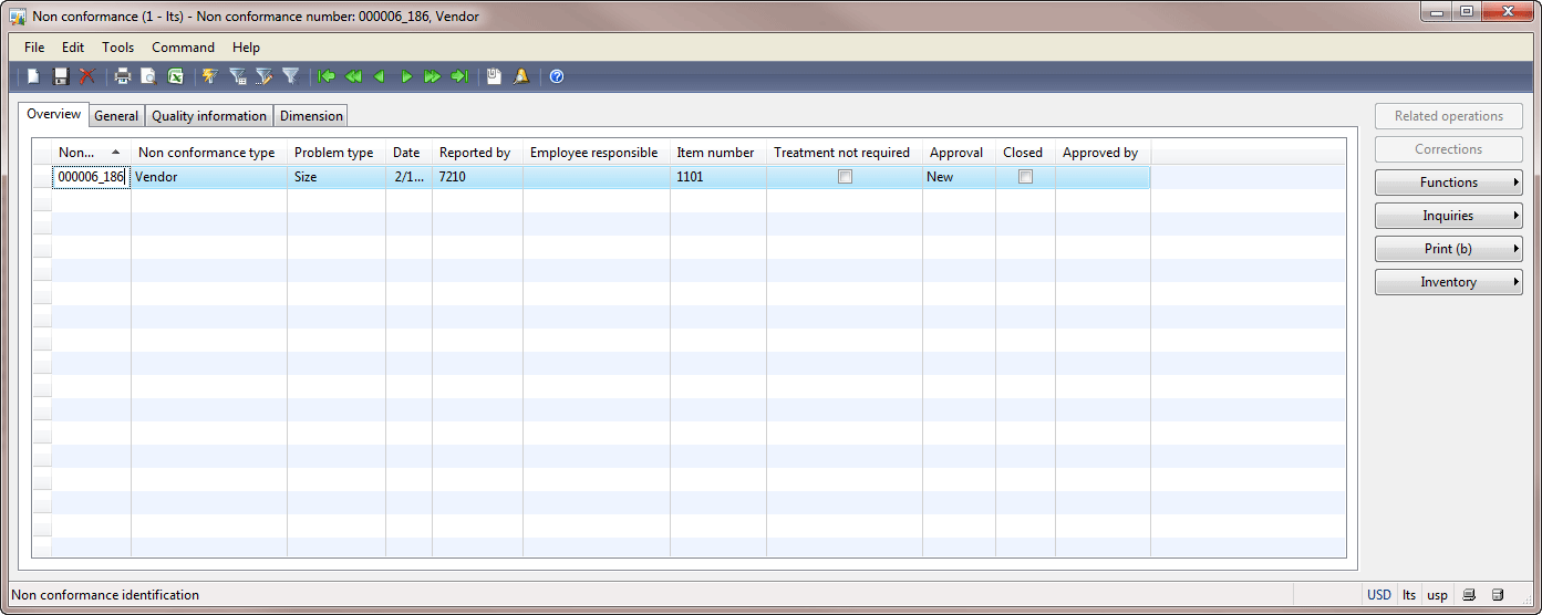

Non Conformance
If the Quality Manager finds damaged or defective items, he or she will create a non conformance. A non conformance document describes the products and items that do not comply with the predefined performance or the quality standards and the problem source.
The problem source is defined as a non conformance type (Internal, Customer, Vendor, Service request, Production).
In Microsoft Dynamics AX 2009, the only thing that we can do with the damaged or defective item is printing and attaching a non conformance tag. Any scrap, movement, or returns are not available now. Also, non conformance doesn’t affect the quality order and vise versa. It means that if all tests for the quality order passed, the non conformance can be created.
The Quality Manager wants to print a special label for the damaged item. To do this, he or she performs the following steps:
  1. Prerequisite: set up a problem type
    1. Inventory management > Setup > Quality management > Problem types. The Problem types form opens.
    2. Create a new line with the following value: Problem type = Size.
    3. Click the Non conformance types button. The Problem/Non conformance types validation form opens.
    4. Create a new line with the following value: Vendor
  2. In the Quality orders form, click Inquiries > Non conformances. The Non conformance form opens.
  3. Create a new line with the following values:
    • Problem type = Size
    • Defective = 1 Non conformance form
  4. Click Functions > Approve non conformance.
  5. The Quality Manager can add the following information for the approved non conformance:
    • operations with cost amount
    • diagnostics
    But this information is not used in the system it is only for the informational purpose.
  6. The Quality Manager closes the non conformance: click the Functions > Close non conformance button.
  7. Print a special tag for the item: Print > Non conformance tag. In our case, the non conformance tag will have the following view:
    Non conformance tag

  4. For damaged or defective items, the non conformances are created. Non conformance doesn’t generate any inventory or general ledger transaction. It only stores the information about damaged or defective items. The only thing that can be done with these items is attaching a non conformance tag to them.
