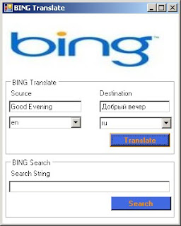

1. Create a .NET APP which would consume the BING Translate API to translate text. The simple UI is as follows and works great :-)

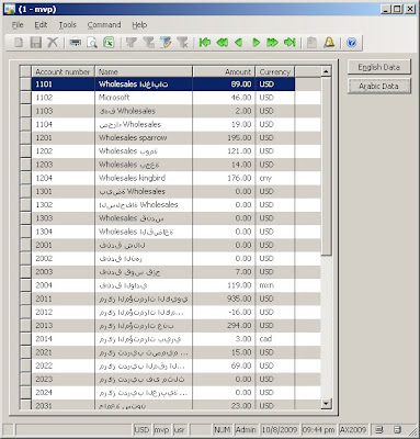

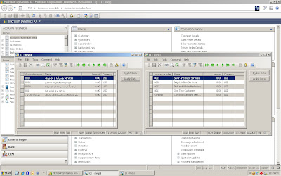

3. Now inside AX, create a form and a tmp table and use the API to translate data on the form. I have created a simple UI with 2 Buttons for 2 languages (en) & (ar). When I press the (en) button, the data is displayed in English and when I press (ar) the data is shown in Arabic. I have used a simple Customer Table query for an example. The Screenshot shows the same form side by side with different data translated :)
Comparison...
