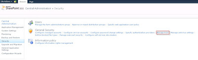

To make sure that we have registered the provider on our Enterprise Portal site, do following:
Go to SharePoint Central Administrator site >> Security >> Manage trust, and make sure that you have FormsAuth there.
Also, go to SharePoint Central Administrator site >> Security >> Specify authentication provider, and make sure that you have Claims Based Authentication provider registered with proper settings.
The main thing is to see if it has Trusted Identity Provider set to FormsAuth.

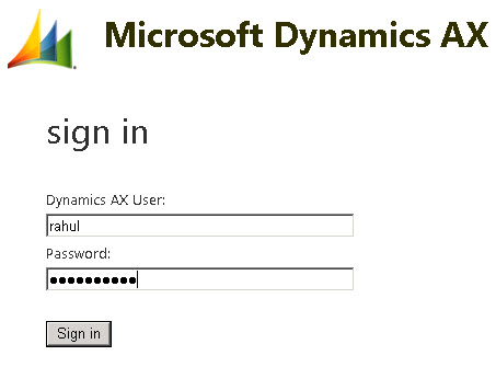

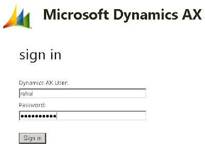

Test functionality:
Now if you go to the Dynamics AX Enterprise Portal URL (https://ServerName:PortNumber/sites/DynamicsAx), the Sign In page will prompt you to select a logon option in a drop-down list. In our setup URL will be, https://ServerName:90/sites/DynamicsAx
If you select FormsAuth, you will be redirected to the forms-based authentication logon site.
After sign in, depending on the roles of that user in AX, you will be redirected to the Enterprise Portal. In our case, user only has vendor portal roles assigned for one vendor. If user has more than one relationship defined then he can navigate from one role to another on Enterprise Portal itself.
