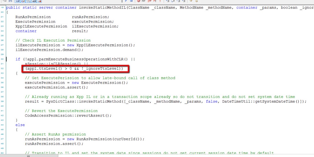

Please do not forget about the third parameter when you call your CIL wrapper.
It won't run in CIL if the current transaction level is not equal to zero, like in the following example with the standard import of Zip codes.
However, you can try to force ignoring TTS level at your own risk.
It works perfectly for my scenario.
This is how to check if your code is running in CIL.
